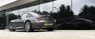

I agree about the softer ride with 18’s but I think visually 19’s definitely suit the coupe better
Shoot these are nice. What wheels are these?? Does the silver one in the back have the same color wheels?
I believe both sets are just standard hyper silver. The stratus ZC is Atomic CSL’s (£600) whereas the silver ZMC is on genuine CSLs and about £1k dearer a set
(The foreground car is the same car as in the lower picture. Stratus just changes in different lights )
Same car here :-
