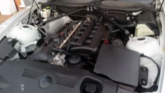

Hey all,
Really need some help trying to figure out what to do next on our Z4...
I've had the car a month or so. It has been stood for the best part of 2 years and we are trying to get it up and running and roadworthy.
The Fault
When the car fires up, it has a rough idle and has a SUCKING NOISE. Sounds like the car is struggling to breathe. Occasionally, when revved, it may cut out before it has chance to return to idle. It is hesitant around 3,000 rpm.
So far we have...
[*]Replaced the CCV and every hose that goes with it - All new and genuine parts
[*]Replaced temp sensor while inlet was off
[*]Had a full diagnosis by an auto electrician and has confirmed MAF is working fine and all fuel pressures are okay
[*]Visual check of DISA valve as well as auto electrician confirming operation
Video
Next Move?
[*]DISA Valve
[*]Throttle Body
[*]CAT
Has anyone had this problem before? It's the removing of the oil cap which is confusing us the most.
Thanks,
Darren
