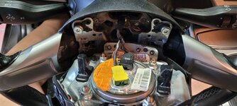

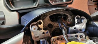

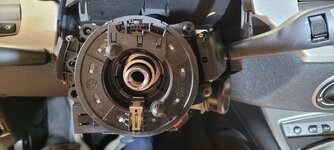

Quick update on the "9855 Resistance, firing circuit...." error.
Had the garage look at it. They fiddled with the pins of the "coil spring" (is that the correct name?) and cleared the code. Ofcourse code came back next day.
So I got myself a new coil spring and a 2nd hand set of cables just to be sure.
Then stalled for 2 months as I did not dare to install and remove the steering wheel.
But turned out to be only a 1 hour job.
Some photos below.
Really not that difficult.
Much cheaper than back to the workshop and have those guys play with the cables again. Just replace the thing.
Used cable set + coil spring were approx 100 Euro.
