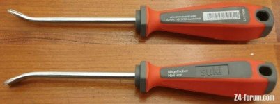

You will find additional water in the following days after your next test drive. Currently it sits in the long frame rails from the back to the front of the car and will drop out slowly. Get all plastic covers removed out of the trunk (use a nail iron for all the black pins) , as water will be in the outer spaces below the ECU's on the right and the little box on the left. Place tissues everywhere to catch each drop.
Nail iron:
