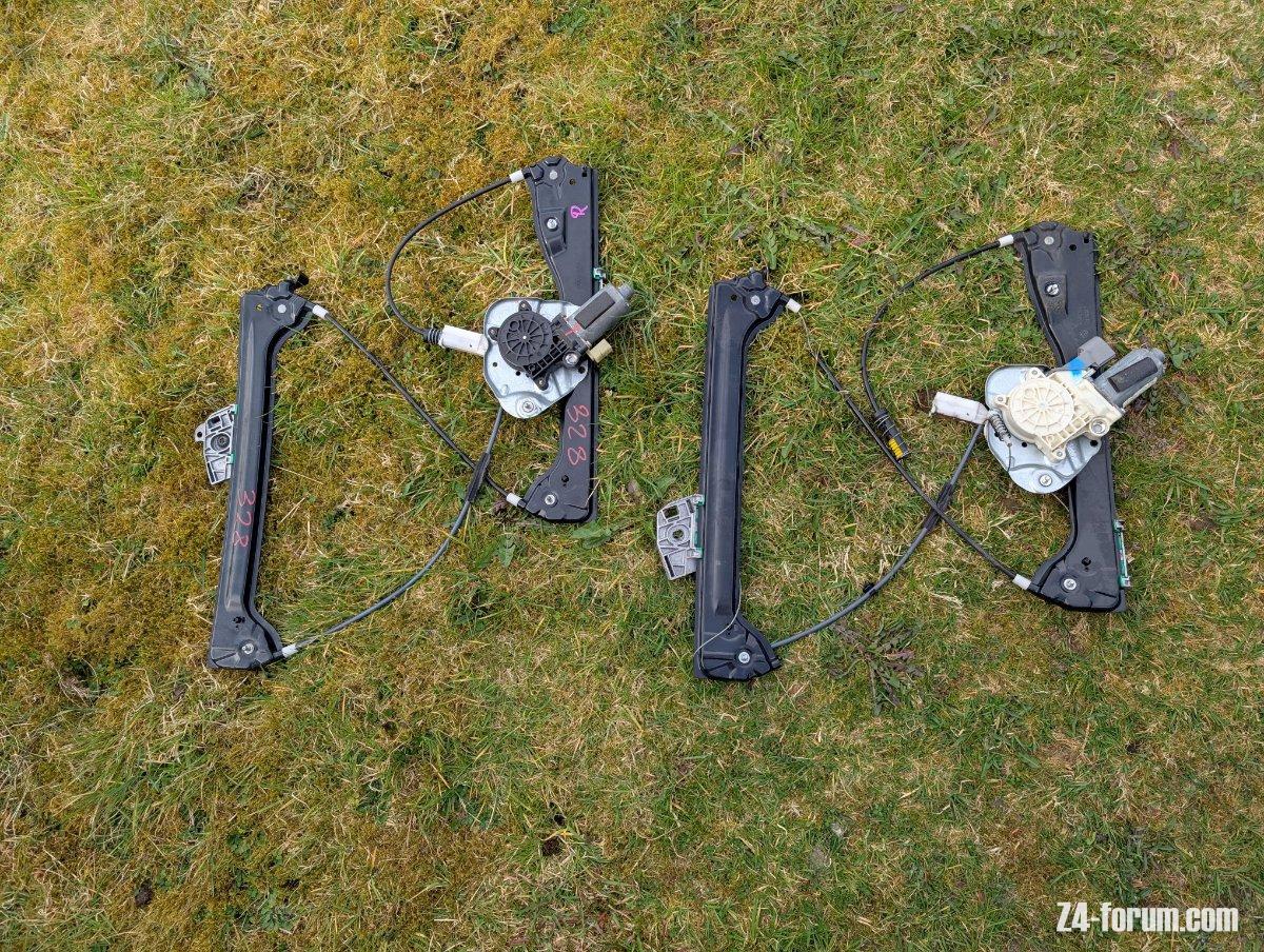

I replaced my driver's side window regulator yesterday with one bought from a breakers but with very little sign of wear. It also came with the electric motor fitted.
I followed an excellent video on youtube by Revive My Ride on how to go about doing this which exactly mirrors what lunny's procedure was. Here's the link:
https://www.youtube.com/watch?v=QPF3dh11F9U
Having removed the original regulator assembly and fitted in the replacement, I then finished off tightening the various fasteners and finally attaching the connector block to the electric motor.....
.....only to find it was a different type of connector to the one originally fiitted. The original was made in Mexico and the replacement made in Germany.
So it was back to square one. Remove the regulator again, swap the motor with my original and then fit the regulator for the second time.

Here's a photo of the old and replacement regulators side by side. They look pretty much identical, but if you zoom in you can see that the motors have different connector blocks:
Regulator comparison.jpg (444.05 KiB) Viewed 902 times
