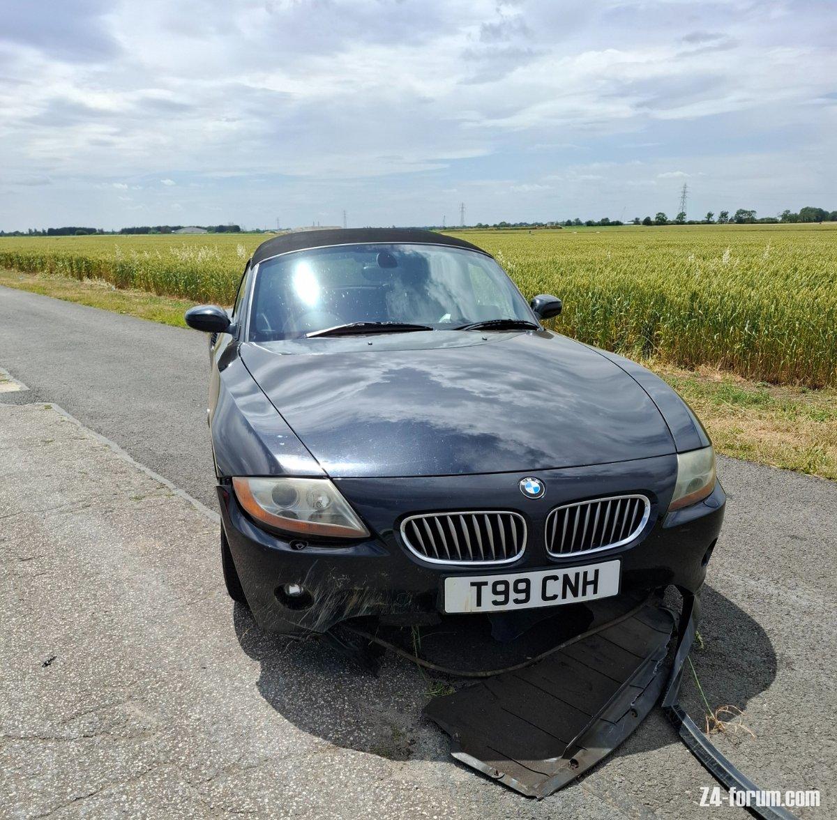

Blyton track day. Brakes failed and couldn't slow the car. Gutted to say the least. :(

Yeah looks like the steering is pissed. Control arm damage?
Brakes just done. Did you run it for a bit? Bed the pads in? Ensure no air introduced in the system.

Yeah ran them for a bit. Have done a few miles on them. They were just normal pads so they didn't have a bedding in procedure. Bled them after too and had a decent pedal.
