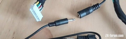

OK, so if that's the case I take it you don't have bluetooth (calls) or the centre console USB, just the AUX? If that's correct, then you don't have anything on the fibre optic network, so this is not a fibre optic issue.
Right, so if you make sure then that the Quadlock that goes directly into the rear of the headunit is the one from the screen, then that means that the audio output from the screen will go directly into the headunit (AUX on-board input), then the speaker output from the headunit will go out and pass-through the screen Y loom and then into the amp quadlock where it will be intercepted, then output from the amp to the speakers (again, hopefully that makes sense).
If that doesn't improve things, do you have this connection on the screen Y loom?...
or
This would then run through the centre console to the AUX socket under the armrest, so you could try this method.
I do have the usb port and bluetooth calls, although neither are used/phone connected. I'll get the dash apart again and check the cabling is set up as per your advice, although I'm pretty sure I've tried every combination. Re the loom and aux-in, it has the one in your first example and is connected.

Arr, right so you've got the AUX lead plugged in the socket in the armrest and you have USB and Bluetooth calls, in that case you need the fibre optic connected. :thumbsup:

AnubisZed wrote: Mon Jun 30, 2025 8:11 pm Arr, right so you've got the AUX lead plugged in the socket in the armrest and you have USB and Bluetooth calls, in that case you need the fibre optic connected. :thumbsup:
So, finally got somewhere and using this little looping fibre cable, problems all solved! Dab still works as I guess internal rather than external, and I've just lost BT phone but I use that through the CarPlay anyway now :)

So, at a guess then I'd say you've possibly damaged one of the fibres, as it would be a huge coincidence for the MULF to go faulty at the same time you added the new parts in.

I've just thought of something,
If you've bypassed the fibre optic, by adding the loop, then the AUX normally goes to the MULF, but if that's the case then you wouldn't hear anything from your screen if it's plugged into the AUX socket! So if you can still hear it and, as you've shown in the photo, you have bypassed it, then the AUX must actually go directly to the Quadlock instead of the MULF.... yest another BMW anomaly :rofl:
Who knows eh, but it works, so I’m happy! Thanks again for all your help 😍
