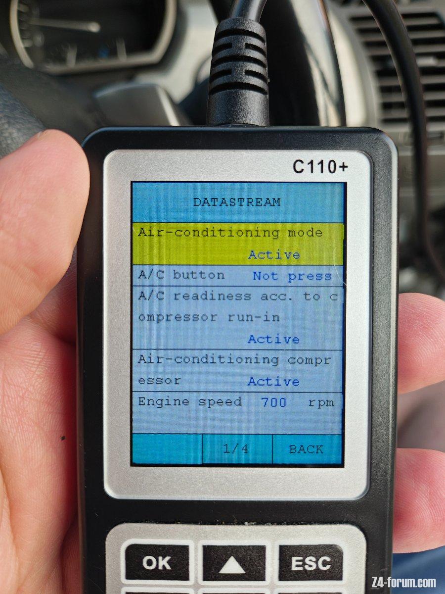

I think you're probably right. This stuff is well beyond my limited abilities!
Not sure if these from my code reader help?
- IMG_20250619_200019838_HDR.jpg (172.98 KiB) Viewed 95 times
- IMG_20250619_200034254_HDR.jpg (189.01 KiB) Viewed 95 times
- IMG_20250619_200048133_HDR.jpg (156.03 KiB) Viewed 95 times
- IMG_20250619_200101406_HDR.jpg (156.43 KiB) Viewed 95 times
