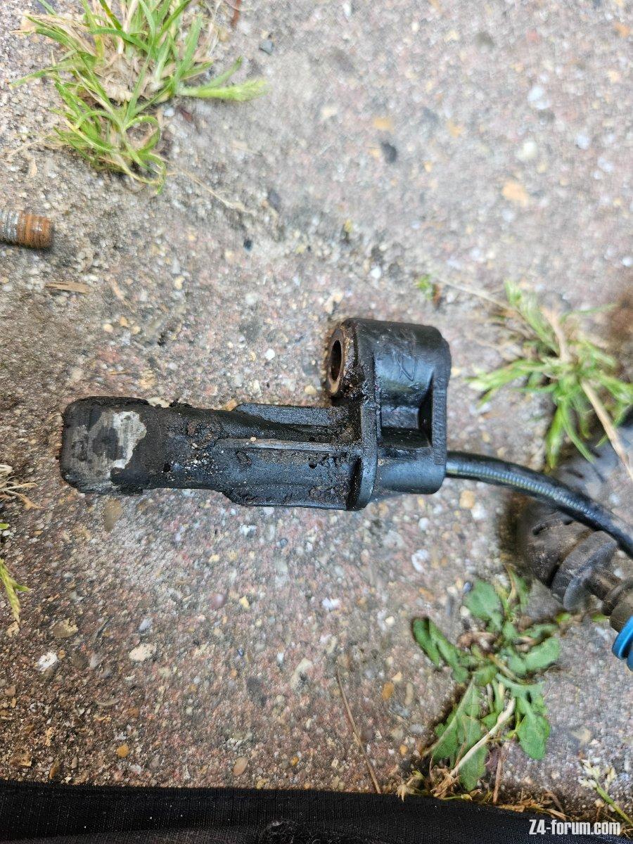

Got INPA onto my laptop. I can't read the error messages as I don't speak German but the front left wheel speed is reading 0km/h which is a little suspicious :rofl:
You may be onto something there. :thumbsup:

Post by lorensomartins » Fri Jun 20, 2025 6:37 pm
enuff_zed wrote: Fri Jun 20, 2025 10:32 am You may be onto something there. :thumbsup:
I was indeed onto something. Lovely to have the lights gone now. :D
The culprit :
