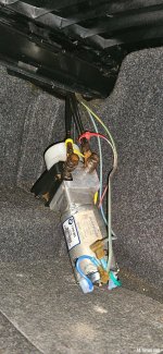

Post by DerekE85 » Tue May 13, 2025 10:17 am
My motor is secured using a short piece of steel around 2.5 inches by 1/2 inch and 2 holes drilled each end this then secured a hose clip to the side panel through the carpet to a steel section The motor is then secured by the hose clip
I have added an image
