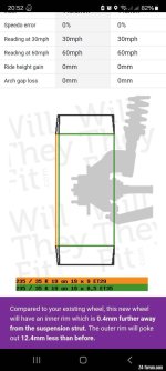

Cheers. Do you reckon these wheels would fit? ET35 is the only option for BMW. Or would the fronts look too narrow?
User avatar
ARCS
Senior Member
Senior Member
Posts: 1170
Joined: Tue Jul 17, 2018 1:45 pm
Location: Scotland/Glasgow
Compatible width and offset for e89 19" wheels
Post by ARCS » Fri Feb 07, 2025 9:54 pm
They should fit with no issues. Happy to be corrected, though.
Screenshot_20250207_205244_Samsung Internet.jpg (65.64 KiB) Viewed 4170 times

Thanks. Where did you get the info graphic from? Looks a really useful site.
User avatar
ARCS
Senior Member
Senior Member
Posts: 1170
Post by ARCS » Fri Feb 07, 2025 11:02 pm
JakeS76 wrote: Fri Feb 07, 2025 10:36 pm Thanks. Where did you get the info graphic from? Looks a really useful site.
https://www.willtheyfit.com/
