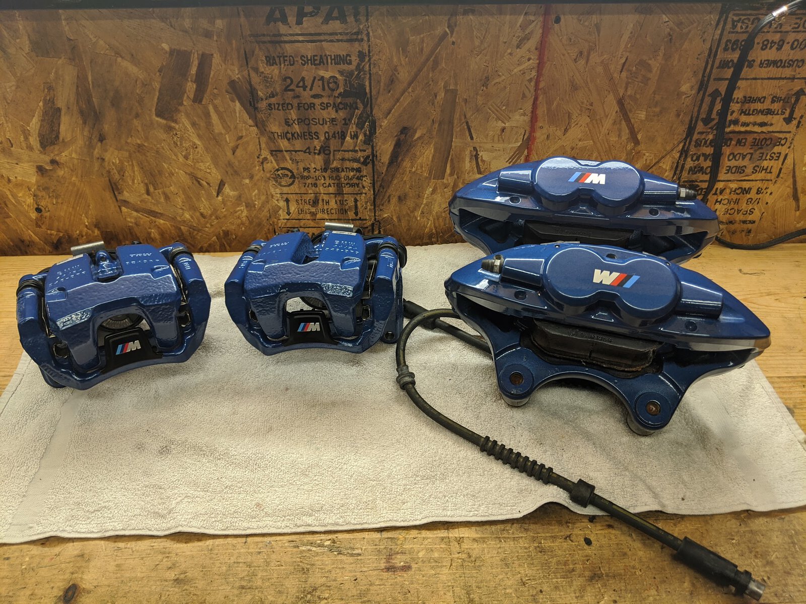

My M5 calipers arrived today…messed around with them and quite quicky, with the steep learning curve I’ve been on about disc/pad/caliper design have decided it’s a bridge too far…it’s only going to work with its own 380mm disc which are £300+ each…so they’ll be going back on eBay…
Strangely the pads look the same so great change in caliper / pad performance just a bigger expensive disk..
