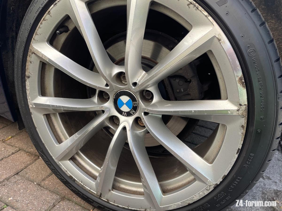

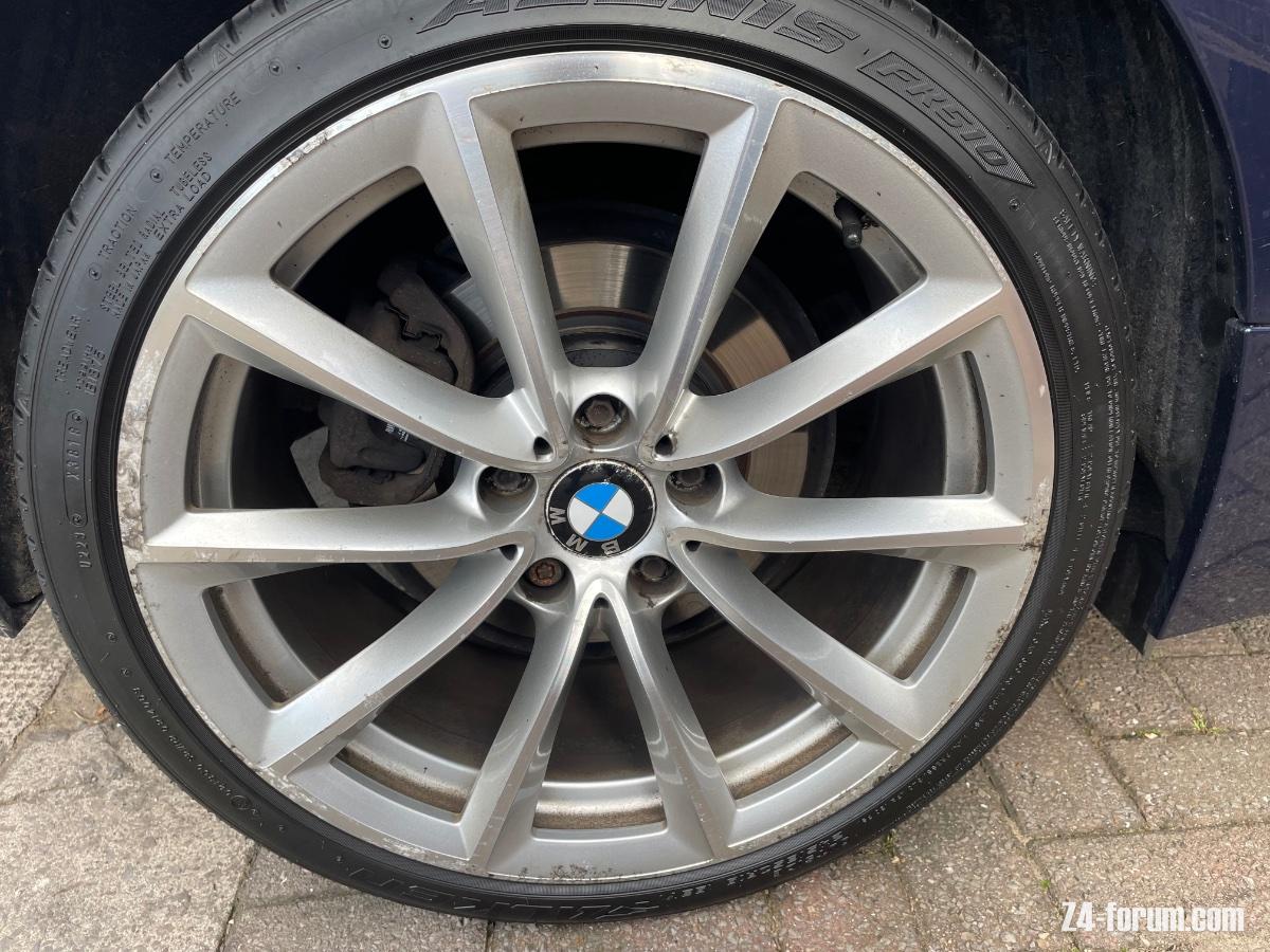

Hi. I currently have 225/35/R19 and 245/35/R19 Falken FK510 tyres which will need replacing soon. Advice at the time also suggested Goodyear F1 A3's and Michelin Pilot Sport 4S back in 2019 but things may have changed since then.
Whilst a big improvement on the original RFT I was hoping the ride would be more comfortable.
A search on here has suggested either a different brand/type of tyre would help and possibly changing the wheels from 19’ to 18’. The latter would be more hassle although I saw something like these locally: https://www.facebook.com/marketplace/it ... 808549617/
Any advice on whether just changing the make or also changing the size would be appreciated, with comfort and road noise reduction being my main aim over the look of the wheel.
Thanks and happy new year

Judging by the pictures you have 296 styles wheels, so presuming the car is an E89?
If so the tyre sizes should be 225/35/19 front and 255/30/19 rears (from the factory). Although your rears aren't far off!
If you go for used 18", just pay attention to the offsets. The ones in the facebook link look like they are from an F series (3 or 4). They have very different offsets to the E89. They will physically fit as the hole spacing and centre bore is the same, but could be all over the place with how they sit on the hubs.
I personally wouldn't buy wheels from someone who thinks that Bridgestone and Potenzas are different brands and think that bald tyres are OK to 'get you home' too!

Thank you Pondrew, that’s helpful and I will avoid those types I listed .
Yes, it’s an E89. When I changed to the current Falkens I changed the size from the originals after checking it would not cause any issues with rubbing etc.
Sounds like if I want to get 18’ wheels I know will work, they come from another E89.
