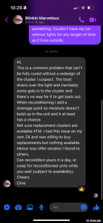

Spoken to him; humming and hawwing over this vs the Chinese option.

E89 Rear light refurb / indicator repair.
This way I did it?
Opening:
https://www-zroadster-com.translate.goo ... r_pto=wapp
Closing:
https://www-zroadster-com.translate.goo ... st-2765283
Since closing/glueing 5 years ago my clusters are stable and still dry.
