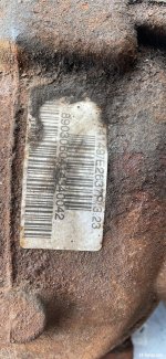

To begin with the context: So I took my Z4 to the garage for a few repairs and the MOT a few weeks ago. One of the repairs I asked them was to replace the rear wheel bearings, as I already did the fronts, and there was a metallic whine in sync with wheel spin especially while reversing. I would actually like to take care of that myself, but as luck would have it I was busy with movig house at the time.
It turns out it's not the wheel bearings making the noise, it's the rear diff bearings... Funny enough, MOT does apparently not care for the state of the diff, so it's not even mentioned as an advisory :|
Anyway, I now need either a nice example of a 3.23 ratio rear diff (part number 7514149), or a bearing kit to fix it myself. Anyone have either of these?

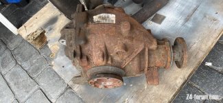

Well... Turns out life has its way of getting in your way sometimes... Since I got this diff from you I got a section 21 eviction due to landlord selling the house, broke my arm (well, fractured), almost got deported because of a mistake my stupid employer made, and have been wating for a conclusion from solicitors, etc. everything finally finally is ok now, and I've started seriously getting into my Zed...
@Street, don't know if you give a toss after all this time, but contrary to what my local garage told me, I think my diff did not really have a problem after all.
I managed to remove it the other day and compared it to the one I got from you. Backlash and the operation of the flanges feel almost exactly the same. And better yet I still have a squeak on my rear drivers side wheel when it rolls. Means the diff wasn't the culprit.
Meanwhile I got in the mood of "while you're in there" and planned for a significant, if not major restoration of the underside. I'm not really documenting it but maybe I should start another thread somewhere.
I really want to drive this thing come July! She sat for more than a year at this point.
The diff below is the one from my Zed. Bearings look surprisingly in good condition (the car has 110k miles on the clock at this point)
I actually found a leak from passenger side output flange. Replaced both seals.
