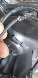

Hey Guys!
Sorry for the late reply- its been a bit hectic.
So- I ordered a cheap hall sensor (PN 54347190735) and placed it between the power supply(pin 16) and signal input (pin 3).
I had to de-pin the brown wire going into pin 3 for this to work.
No Bongs/roof errors!
I was able to get the roof up but couldn't find any breaks in the hall sensor wire.
I then probed the de-pinned pin 3 and saw 12 volts on the pin- according to Robbi this meant the wires were shorting due to a crack.
While working on the right side hall sensor, the left side switch on the rear shell also threw a code!
Similar to the hall sensor, the microswitch had a short due to cracks in the wire.
The cracks for the switch were at the pinch point where most of our wires break.
I replaced the wiring on every switch/hall sensor in the rear roof shell with Silicone Cover Stranded-Core Wire from Adafruit- this stuff is SUPER flexible.
Its been 2 days and the roof has been operating without any issues.
Thank you guys for the help!
