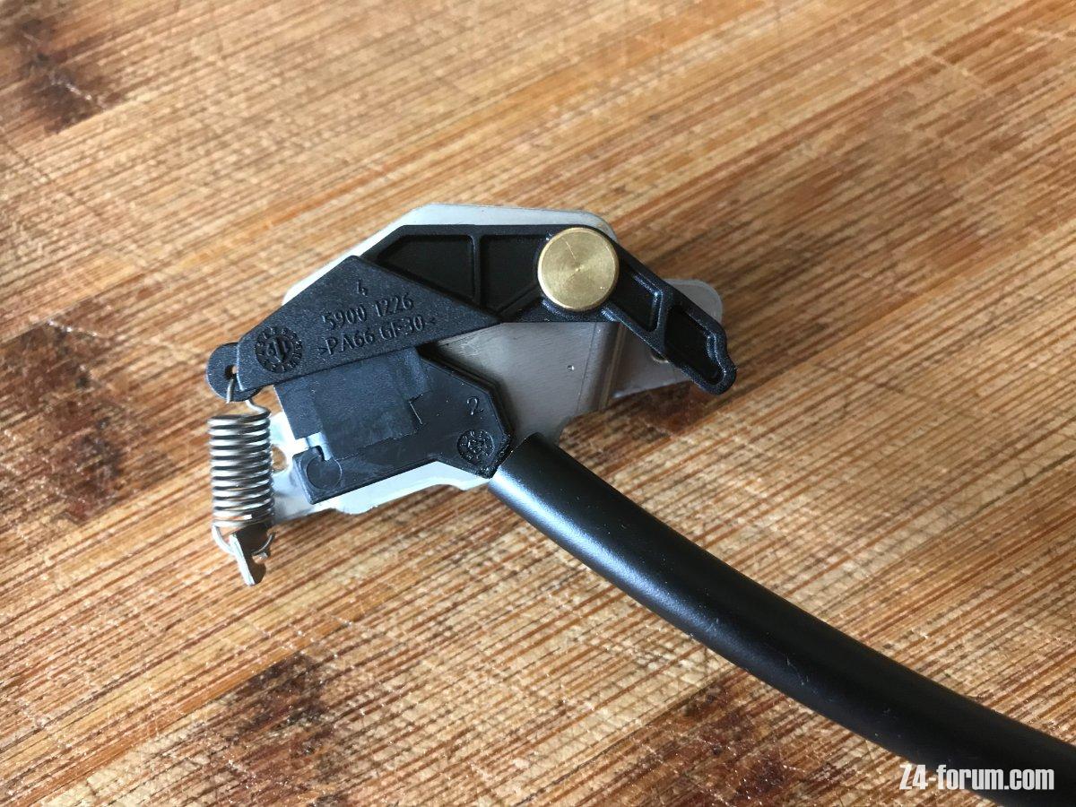

Small roof issue (surprise surprise)
54377228585Pondrew wrote: Mon Jun 07, 2021 4:14 pmWhich switches are they; and where are they located please?RobbiZ4 wrote: Sun Jun 06, 2021 11:22 pm These issues are always based on corroded microswitches coupling lock, nothing else.
Both should be replaced latestly after 10 years to avoid these random issues!![]()
54377228586
viewtopic.php?f=45&t=128428
- 2021-04-18 09.34.05.jpg (215.73 KiB) Viewed 3758 times
- 2021-04-18 09.35.13.jpg (91.08 KiB) Viewed 3758 times

Thanks Pete! I'm presuming these are on either side of the bootlid mechanism below the rear window? I did view the other topic but am still not quite sure where they arePbondar wrote: Mon Jun 07, 2021 4:28 pm54377228585Pondrew wrote: Mon Jun 07, 2021 4:14 pmWhich switches are they; and where are they located please?RobbiZ4 wrote: Sun Jun 06, 2021 11:22 pm These issues are always based on corroded microswitches coupling lock, nothing else.
54377228586
No Z4 anymore!
No Z4 anymore!
Correct-ish..when the roof is stowed you can see either side above the wheel arches in the boot two chunky arm assemblies..they are screwed in there!Pondrew wrote: Mon Jun 07, 2021 5:49 pmThanks Pete! I'm presuming these are on either side of the bootlid mechanism below the rear window? I did view the other topic but am still not quite sure where they are![]()

The issue is that the switch has a small rubber ‘nipple’ over the press to switch part of the microswitch that gives an impression of sealing it
Inside there are dissimilar metals so with a bit of damp corrosion sets in
Even though Robbi mandated a swap out in my case with frequent use and warmer weather the fault has not re appeared so I plan to swap it out at my convenience
