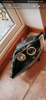

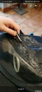

I used this to split a headlight I have. viewtopic.php?f=2&t=100058
You can use a multi tool with a thin flat bade, this is a good option IMO. All details in the link.
In my personal opinion the lenses can be sanded and polished up. You should be able do rectify it 99% of the time without cutting open. You also don’t know the quality of the replacement lenses. OEM... Almost 20 years and they still have good quality (yes superficially they might be fading and cloudy).
