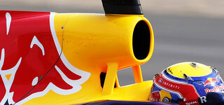

- Why when Formula 1 car were Naturally aspirated engine, the rules limited the size of the air intake?
- Why so big??
