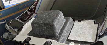

2. Trunk area
Half-open roof state
Remove the lining by pulling the plastic trim screws out. (you need a metallic trim removal tool for this)
