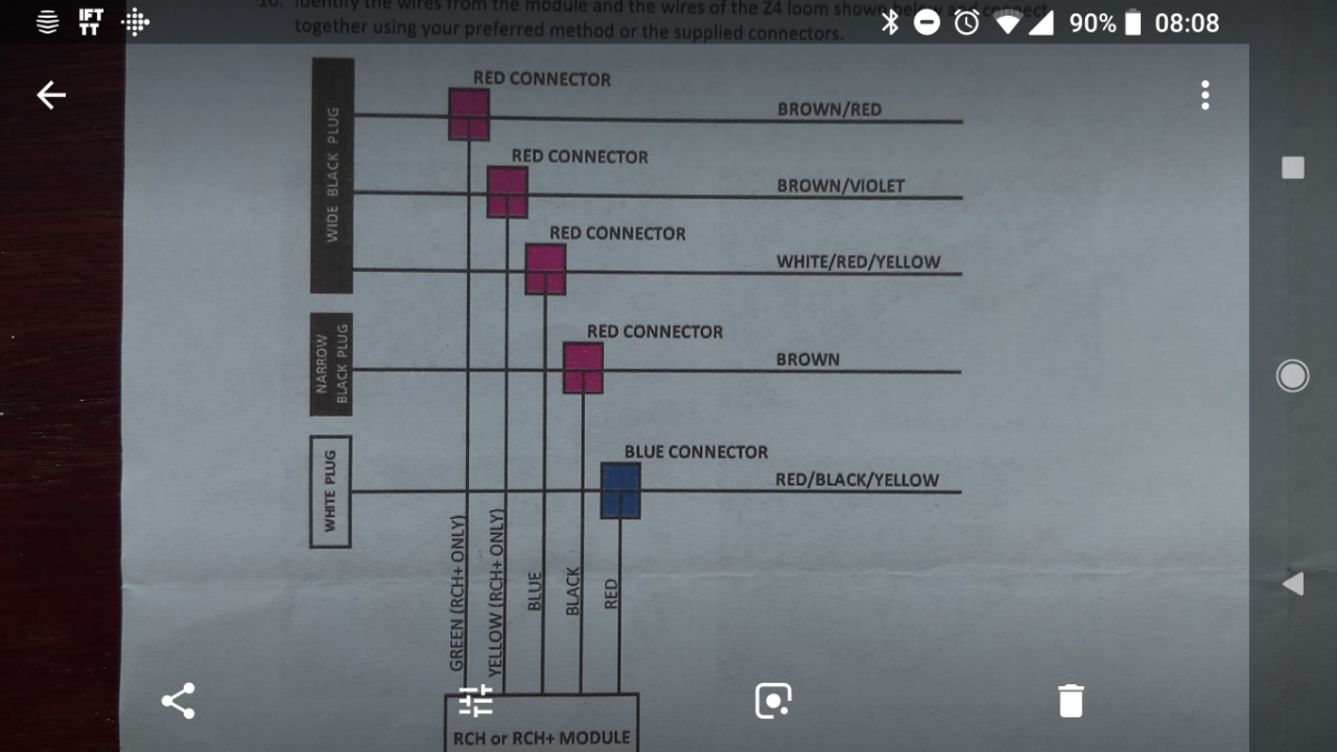

The previous owner removed the remote roof module and left in glovebox. But no wiring or fitting instructions. Anyone got a list of what colour wire goes with what unnder ashtray.

Try this

8) great many thanks :thumbsup:
