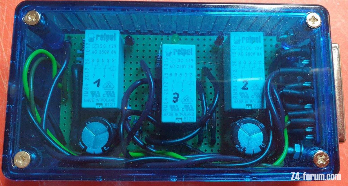

Upgrade process of the K5 BlueBox to integrate the new 4-series convertible:
Before starting
Opening of the BlueBox
While soldering the additional wires to the G23/G83 plug
Integration completed
Ready for testing
Re-mounting all plugs
Top view

RobbiZ4 wrote: Sat Oct 08, 2022 11:58 am [...]
Completed:
Addon interface box for the concentrators K2 ... K6 to manually control the front locking motors. Up to now this feature was only available in K1 for the E89/E93 models.
Arrgh, during a test session on an older Z4, here's what happened to my new addon interface box for the front locking systems:
Melted conductor tracks on the circuit board.
I had to redesign the complete unit and added an electronic overload protection (shunt, transistor, relay) to timely shut down this unit if a short circuit or current overload occurs on the front locking system. This additional group was placed on the left:
My test environment with 3 different front locking systems: E93 , F33, E89
