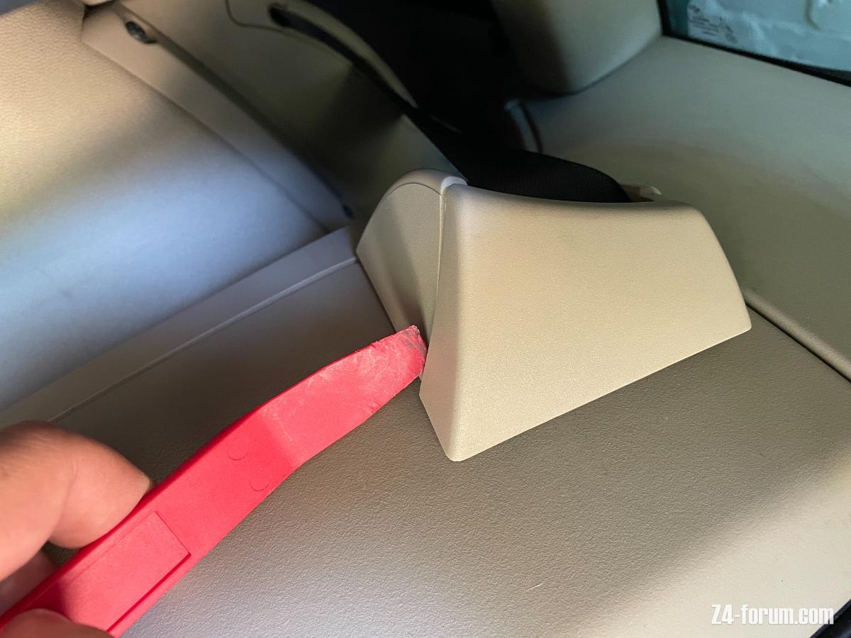

1) So first off, remove the centre trim - it lifts up and away pretty easily with your fingers.
2) Next up is to remove each rear seatbelt guide cover. You may need a trim tool but they come off quite easily.

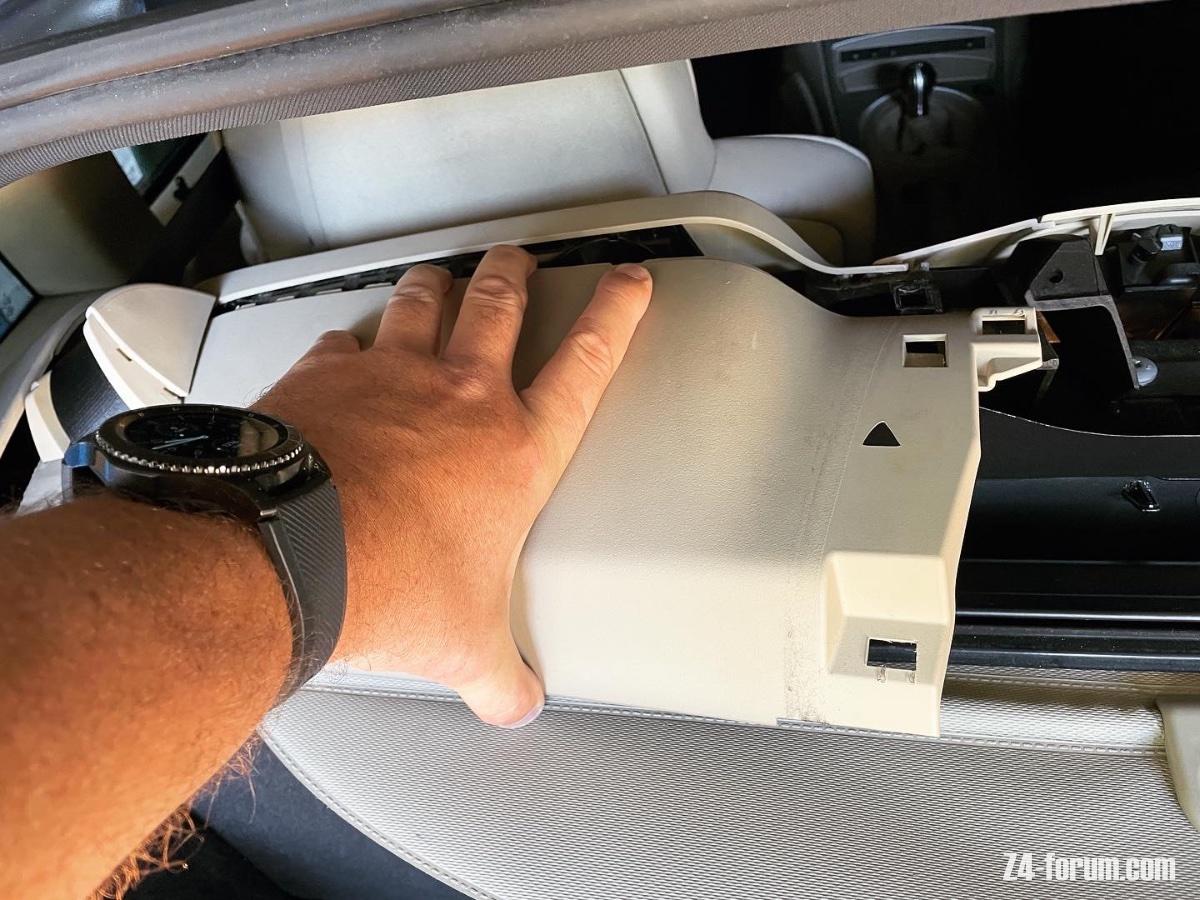

3) After removing both of those, turn your attention to the left and right top pieces. These require a little bit of force and there’s a black square tab that locates into them, but shift it back and away and you should be fine.
You should now be at this point…..
