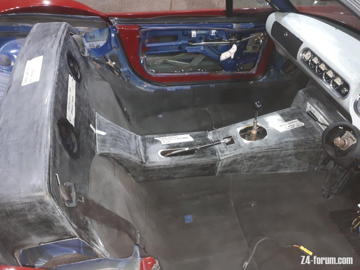

Post by Pondrew » Tue Jul 01, 2025 1:33 pm
Many people don't bother changing the interior, or certainly the dashboard, on these when building them.
I can now see why! What a PITA it is. There is zero room for all the wiring to fit behind and altering the electrics to suit the new gauges is a complete nightmare. Then you have the new heater controls (flexible wires); like trying to wrestle an angry snake in a shoebox.
But it's done and all working! I now have to dismantle the whole lot to finish the dashboard, before doing it all again. :(
I have probably mentioned this many times on this thread...but for anybody thinking about building a car.........JUST DON'T! :o

Post by MikeyH » Tue Jul 01, 2025 1:53 pm
It will be worth the extra effort Pondrew :thumbsup: This car is going to be amazing :thumbsup:

Pondrew wrote: Tue Jul 01, 2025 1:33 pm Many people don't bother changing the interior, or certainly the dashboard, on these when building them.
I have probably mentioned this many times on this thread...but for anybody thinking about building a car.........JUST DON'T! :o 20250701_124953.jpg20250701_124932.jpg
Quit whining and get it built…we need to see it…. :poke: :poke: :evil:
