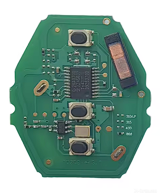

Now onto key fobs..... The car came with two keys, one that works perfectly (works = all buttons work and they what they should) and one with (I think) had a dead battery. I proceeded to change the battery in the second keyfob and knocked out a couple of components (read the warning about delicate opening only after)....
I proceeded to buy a cheap 433Mhz diamond key from Amazon, charged the battery, got it cut, and ran into issues trying to program the fob.... let me explain.
I try all 3 pairing methods with the working key, and the car responds as I expect it to (locks shoot up and down). When I try any of the methods with the new key (standalone or immediately after programming the working key), the car doesn't respond, zilsh, nada, nothing... and obviously the buttons do not work.
I am a little bit stumped because as a diagnosis, I think:
- GM5, wiring loom, locking mechanisms all work (as evidence by the good key getting a response)
- I triple checked the new key and the old key are on the same 433Mhz frequency
- the only thing i can think of is that the Amazon key is speaking a different language???? or that the car doesn't go into programming mode and just humours me with the locking/unlocking sequence
Does anyone have experience with those cheap keys and maybe any recommendations?

That's what I had assumed as well so - in theory at least - the (Amazon) key fob I have should be able to be programmed via finger dance.... mystery remains.... have ordered a new one and will test that (in case I have a dudd), I can always return it if it doesn't work...

For posterity, if anyone ever comes across this problem, the first Amazon key didn't work, the second worked.... from what I gather the PCB with the antenna that loops around the edge WORKS, the one with the visible coil DOES NOT WORK. Of course, it could just be my car.
