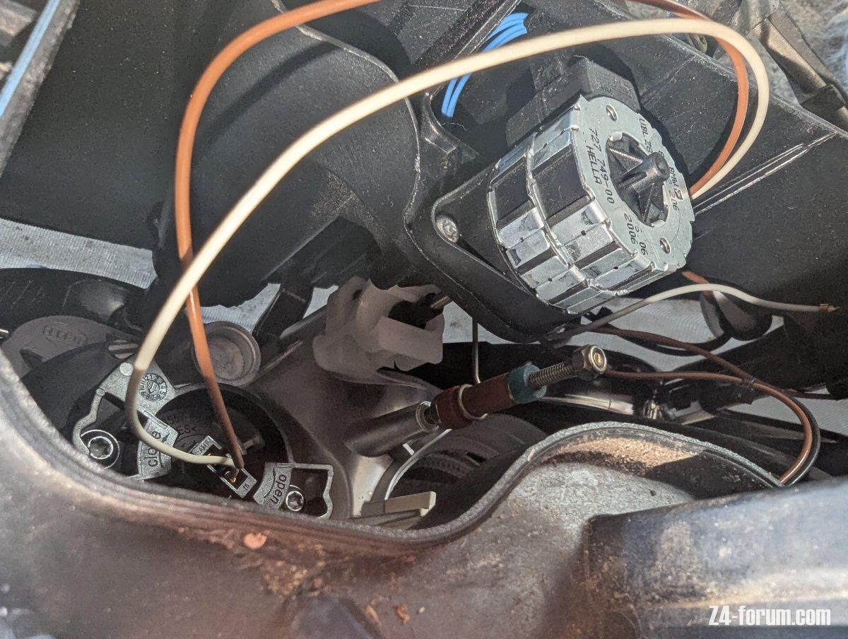

- Posts: 6
- Joined: Sun Jun 15, 2025 10:55 pm
Someone Help!! Headlamp Levelling Device
Hey so thanks for all the advice here's a picture of the vehicle is 2006 2 litre also to mention it says offside doesn't specify whether it's rear or front
- Screenshot_20250616-122656.png (376.98 KiB) Viewed 236 times
- enuff_zed
- Posts: 18132
If it doesn’t have xenon lights it won’t have the levelling system so can only be a motor in the headlight. On the light switch unit do you have two adjustment wheels or just one for the instrument lighting?
