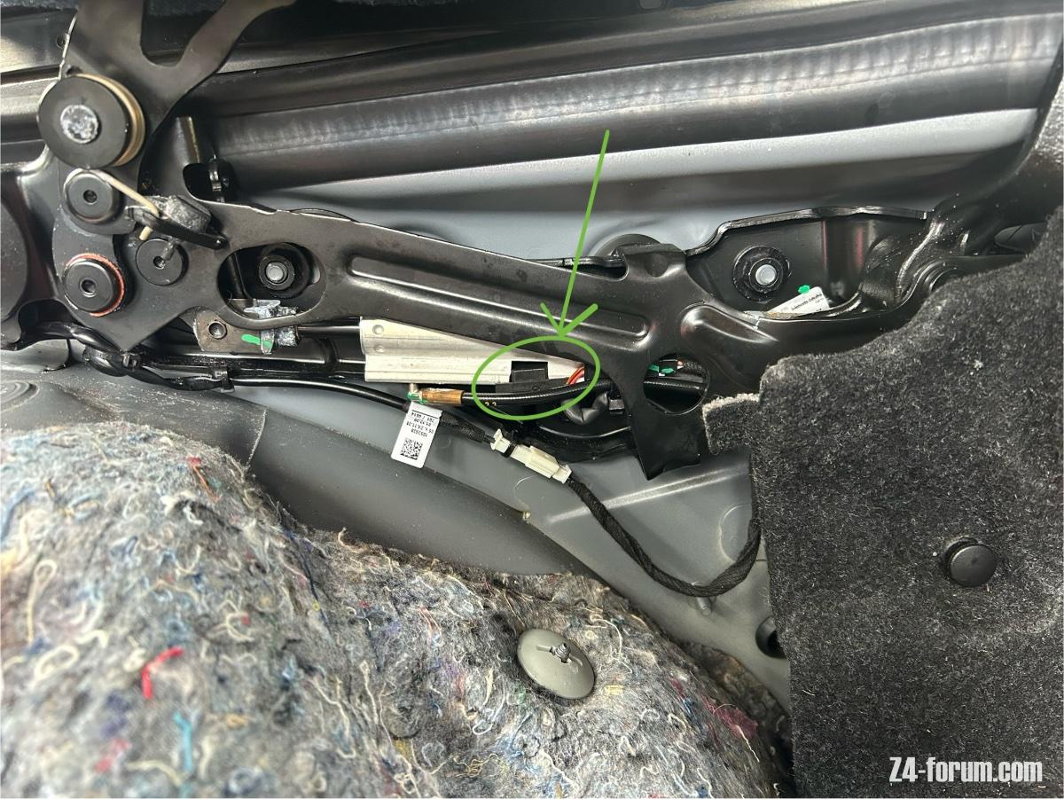

I did this yesterday, easy fix and a 30min job to get the roof properly working again.
Call me lazy, but rather than crimping on connectors etc. I simply just chopped off the old connector and soldered the new HS onto it, trimming to the same length as the old sensor cables. Brown to brown, yellow to red. Clip in the HS, fresh cable ties and all done.
Part number for the HS I used was 54347190735 at a cost of £14.30. Far preferable to the £190.74 they wanted for 54377224679.
Picture of the sensor location in case it helps anyone reading this how to guide:
