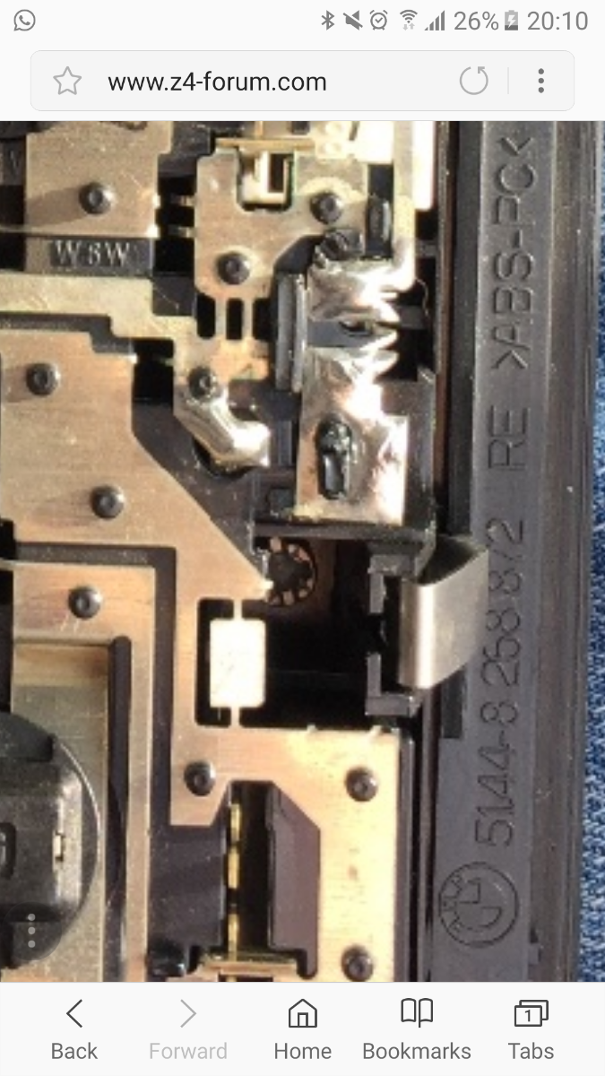

jamie_z4
Posts: 4621
Joined: Fri Dec 31, 2010 9:38 pm
How To: Interior and Rear License Plate LEDs
Post by jamie_z4 » Thu Sep 14, 2017 8:11 pm
See it?

You can still fit the leds to the dome and reading lights, just take the plastic cover off and put them in from the other side. It's just a bit awkward to do.
