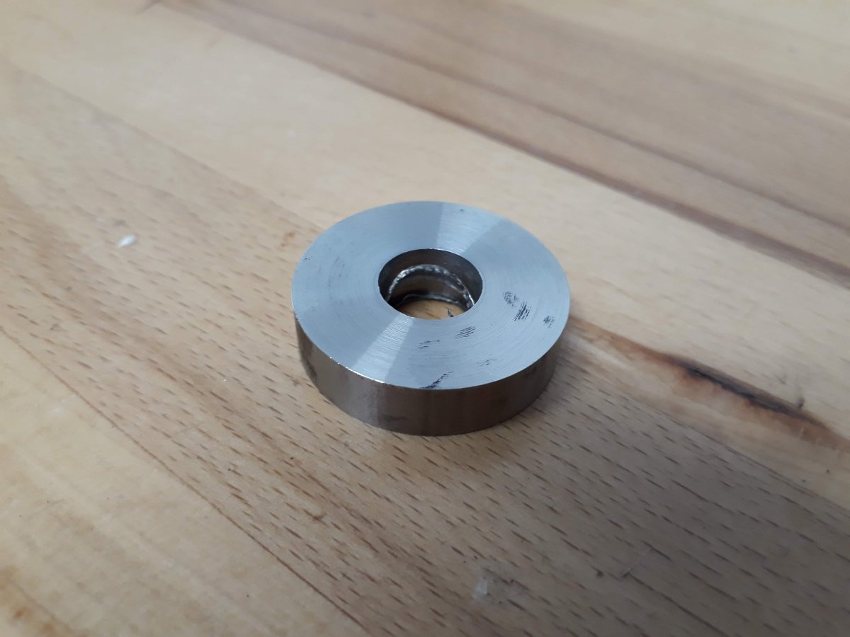

hopz121 wrote: Fri Jul 05, 2019 3:33 pm You have any pictures showing spacers etc?
Interested to see how you mounted them with the spacers.
Unfortunately I didn't think to take any photos of the actual mounting. Here's what the spacers look like though. They simply sit between the knuckle and the caliper bracket.
