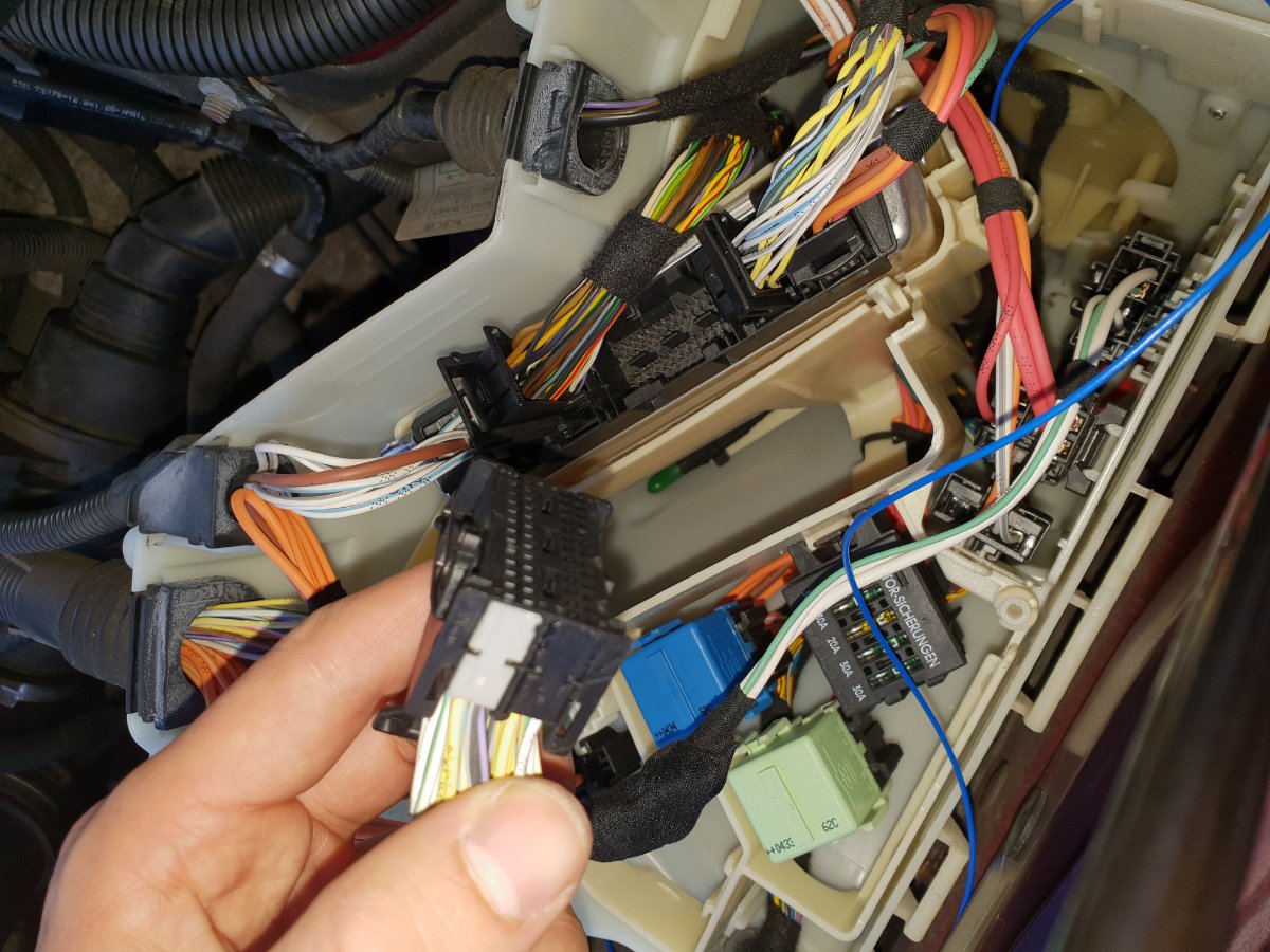

Blue cable was easier than expected to push up into engine bay.
Now which connector is it this one and is it pin 39?

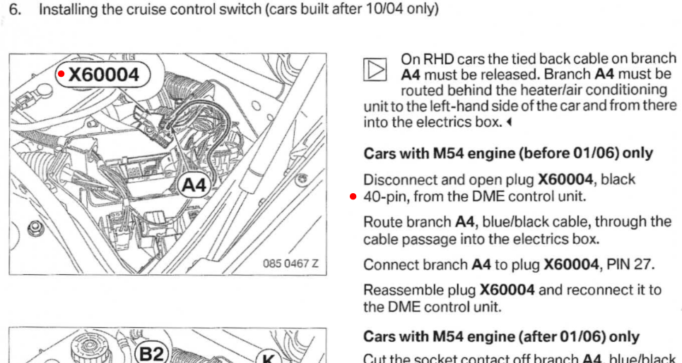

For reference to anyone carrying out the retrofit on a pre-2006 M54, I've taken a screenshot of the BMW guide - blue cable goes into PIN 27 of one of the 40 way connectors, looks like the 40 way closest to front of car.
