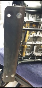

Fitting of the rails:

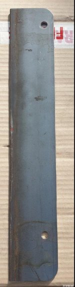

I am trying to make a set of plates which everyone regardless of skill level should be able to make. I can weld and have access to welder at work but wanted to avoid that as most people don't have that luxury. You will need a pillar drill though and an angle grinder as well as other tools but those two are the most expensive ones you'll need.
My car is in the garage with only just enough room to get in and out so I have made plates blind but with seat bases from an E85/6 for guidance in my shed.

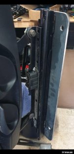

Now the rails on one side of the seat almost fit perfectly. With the rail mounted on the front bolt the rear hole is long by about 3-5mm. The bolt almost goes in so this hole needs elongating.
The width is too narrow on the e89 rails so they need to be widened. I, in my error, made plates to widen the seat buckle side but after test fitting realised I need to widen the rails on the seat controls side.
The plates I have made were actually spot on though for the measurements so I just need to re-make them for the otherside.
This is a work in progress and will be at least a week before I can make new plates and re-fit the seats before I can show you what to do.
The seat belt will bolt onto the seat fixing but will need spacers and a longer nut. More information on this to follow.

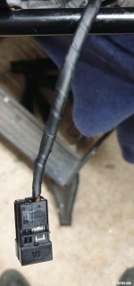

Passenger seat occupancy sensor update for facelift cars.
The wire colours coming from the e89 seat occupancy sensor are the same colours as the wires from a facelift sensor pad. I can't test if this will work as my car is pre-facelift.
E85/6 facelift sensor wiring:
E89 wires coming from sensor:

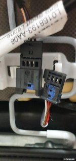

Under the seat you'll find a yellow box:
If you hold open two tabs you can slide the connectors out from inside.
Bottom left is for electric seat, the Lordosis, seat occupancy sensor and heated seat.
Left is for the pretensioner
Next to that on the right is for the Air bag
Far right and slightly out of focus is the heated seat connector which goes into the heated seat module.

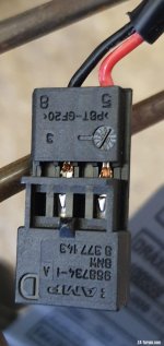

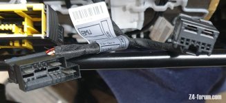

Pretensioner Wiring
Pretensioner Connector
Wires
Remove Red and Black wires
Connect them into donor plug from e85/6
Now looks like this
Remove Yellow and Blue wires
Remove green rubber and tighten top clips up where green rubber was connected, make sure they are as rounded over as possible.
Remove Yellow block connector from e85/6 seats and remove both black wires
Insert Yellow and Blue wires into e85/6 Yellow Block connector. Whichever way round you prefer as I don't know which is the correct way round but connecting them the way I have does not make the pre-tensioner fire when you connect the battery and start the car. I have no idea if connecting them this way that the pre-tensioner will fire in the event of a crash.
Insert Black plug in Yellow block connector

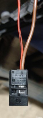

Lordosis Wiring
Here is the main connector from the e89 seat with the heated seat module connector to the right.
Remove the sheath, it's sticky and quite difficult.
Pull out the pins and put to one side, we will need this in a moment.
Passenger seat only* find the connector at the back of the seat base and unclip it. The connector to the left is the one you now need to untangle back to the main connector block
Remove the pins from the main connector block
Now remove the last 2 pins from the main connector block. These are for the Lordosis
From the heated seat loom you just put to one side remove one of the large spade connectors. Very difficult, use a pair of side cutters to carefully open the tabs and remove the wire
Connect the spade connector to the red/black wire for the Lordosis

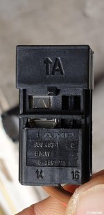

From the e85/6 seat remove the pins from the electric motor connector.
Slide the pin of the brown wire (ground) for the Lordosis into number 14
Slide the pin of the red/black (positive) for the Lordosis into number 13
Wrap wires in self amalgamating tape

I know the photo of the seat looks stupid but it will fit perfectly when I have the brackets fitted properly. The ones I made for the drivers seat actually fit the passenger seat in the correct place so it wasn't wasted time. Also the seats will look better when cleaned and repainted New England Beige.

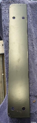

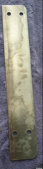

Making and fixing the Rail Brackets
This basically jumps in a little late I sometimes get carried away and forget to take photo's. When I make the plate for the passenger seat I'll update with all the measurements but I do remember some. This bracket is for the drivers side but the passenger side is just the plate flipped over.

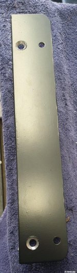

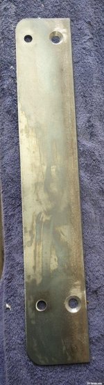

I have a cut piece of 5mm thick plate to a length of 46.5cm x 7.8cm, rounded off the edges and drilled the first 2 holes which is 12mm. These are the holes that fix to the car
Drilled 2 more 12mm holes and these are for fixing to the seat rails
Next is to countersink the underneath of the holes that fix to the seat rails
Using 25mm M10 countersunk bolts I check the fitment to the rails.
Photo shows a standard nut but I did use a lock nut before fitting to the car
Before putting them in the car I quickly wrapped them in insulation tape to stop the plates soiling the car interior. They will be painted eventually
Unfortunately in my haste I did the best side on the underneath
The tape I used
The rail on the other side of the seat needs this lip removed
Lip removed
Now the seats can be fitted
