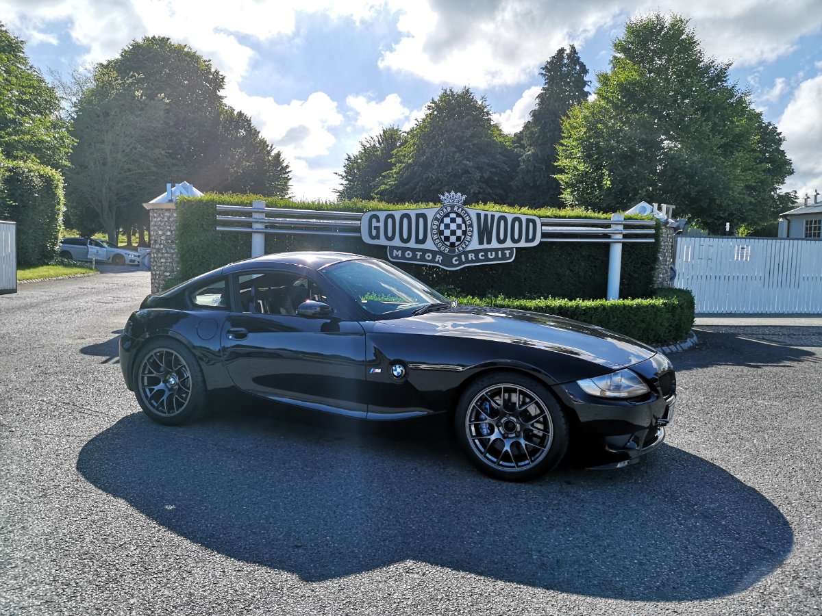

Edit: pic 1 below is 18" arc 8s, and pic 2 is my car on 18" ex-7s :)

On the wheel size side of life - to give you a bit of info on mine - my alloy sizes are18x8.5 ET35 on the front and 18x10 ET25 on the rear.
Tyres are 245/40/18 front and 265/40/18 rear.
The rear arches appear to have been slightly rolled on the inner lip to accommodate the tyres, and there is evidence of the arch liners having worn. That being said my car is a track car so has been subject to a lot more cornering loads and therefore damper compression than on the road. Also the rear tyres are quite high profile for the width!
To be quite honest I'd echo what others have said - get the car, and see what physically works. This website is a good one for checking wheel and tyre combos against standard so you can cross check your physical measurements: https://www.willtheyfit.com/

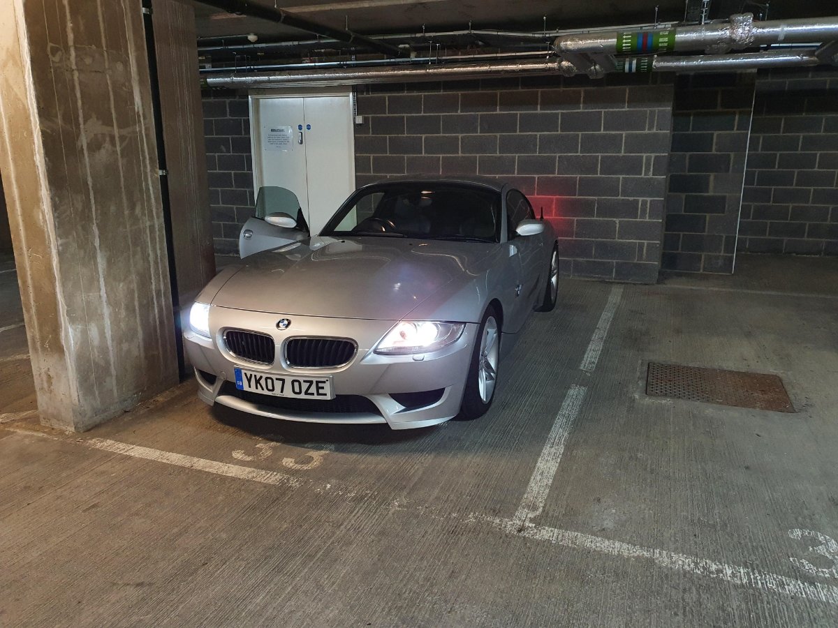

Evening All,
Just picked up the car! Spent all evening going through the Service History and putting it in order.
Only did a 30 min drive in London back to the flat. But tomorrow evening back to Devon!
So far upcoming issues / tasks are:
Key Fobs need batteries
Wheel and Car badges need renewing
INS 1 due in 1000m
Key Fob needs a badge

Looking cracking Dan. 8) Safe drive home . Hope to see it in the metal in the not too distant future. :thumbsup:
