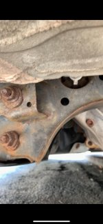

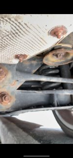

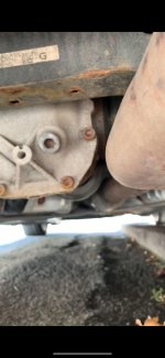

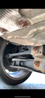

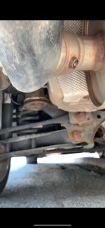

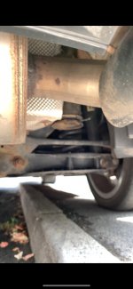

Put it down to relative inexperience perhaps, but my nephew Matty has bought himself what he thought initially was a lovely M135i. Makes all the noises and moves he was looking for but sadly he’s now discovered it’s infested with corrosion.
He’s had it more than a month so he’s out of the 30 day cooling off period so can’t return it but still inside the 6 month window where the seller is obliged to address any issues to the customers’ satisfaction. If the ensuing repairs are not to the sellers satisfaction then the buyer has the right to return it apparently.
BMW chief mechanic is refusing to play ball when Matty sent photos to them stating it was within acceptable limits of corrosion and had passed its MOT. Thats a bit of a whitewash if you ask me.
It’s going into Arnold Clark BMW tomorrow, where it was originally bought from for their own appraisal.
My suspicion is that they will fob him off with a basic repair and replace a few of the rusty bolts and fasteners but I’ve suggested that he push for a replacement car if a refund isnt possible. There would be no way to tell, apart from stripping the car about how deep the corrosion has penetrated.
I’d be absolutely livid tbh, but then I would have probably spotted the corrosion in the first place and this leads me to ponder exactly how this can be sold as an ‘approved BMW’ in the first place!
Any advice from you sage old lot?

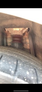

Some photos. He sent me a short video where you can see also the steering linkages are corroded.
These are just the components and areas that are visible! Imagine the state of the brake lines, fuel line etc.
I don't actually think any of that looks too bad to be honest

I can't really agree with your argument - as the car is fit for purpose and completely safe, and just looks like a normal amount of corrosion for a car that's used on UK roads (unless it was sold as a low-mileage garage queen and kept in a humidity-controlled bubble)...or are you saying some surface corrosion is totally unacceptable in a 2nd hand car?
I suspect its been left on the quayside while the previous owner worked offshore for weeks at a time. I have next to no rust on a 2007 E86 , in comparison to that.

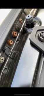

If anything is going to rust it will be external nuts and bolts although from the pics it does look a little worse than you would expect, I assume it's an earlier pre LCI car. The rusty nuts on the front engine scuttle are a bit odd though and seems excessive. Has the been kept on the coast, driven through seawater. You won't stop tinworm unless like me the car is garaged 99.9% of the time 364 days of the year :)

Looks a bit unsightly but it’s just superficial and won’t fail an MOT test because of it-I’d be amazed if they gave a refund to be honest :?
Rob
:o Not nice, maybe lived at the beach. Suspect he may be stuck with that one though. It's clearly road worthy. Hope I'm wrong. May be worth enquiring what protection can be applied, to reduce the rate of spread. Hopefully the dealer may offer something along those lines.

Clearly road worthy :)
No holes or serious corrosion on the chassis or suspension pickup points. Same as any other (assuming) 7 year old car that has lived outside.

I think your alone with that view im afraid, every time i've been under a BMW (bear in mind ive owned over 50 now) ive seen stuff a lot worse than the pics above.
Looks fine to me (front end bolts are questionable). I’d ask for the unsightly ones you can see to be tidied up- about as much as you can realistically ask.

Sadly it does stink, but Mr Joe Average , buying a car wouldnt know a locking wheel nut from a door lock, which is what they work on. I suspect the previous owner PX'd the car for a new one from A.C and they just punt it on , with the view of a profit. Thats the motor trade . As to where you stand on this, thats an awkward one. The vehicle has an MOT and is road legal. The probability of living an average life of the type is pretty low. A.C , judging from people posting on Pistonheads are not the best since AC himself sold the buisiness. Sadly , your chap , spending a decent sum of cash and relying heavily on a car dealer to be up and honest, rather than knowing what to look for should have had an independant inspection. Hindsight is an amazing thing. You could make a complaint with A.C and see what their response is, but it may not be what he hopes for.

Yes, that doesn’t look too bad to me either. Not the best, but close to what I’d expect for anything but a garage queen.
