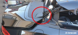

Strange Request (roof issue)
Fine! Here we go:bte123 wrote: ↑Tue May 18, 2021 5:42 pm Absolutely, and I've just had a good giggle reading through the replies here. Here goes, keeping it brief where possible.
Opening:
Press to open roof - immediate BONG and red window warning on dash.
Windows go down, cowl comes up onto roof, roof begins to open and boot opens a fraction.
If continuing to open the roof will crush into partly open boot lid.
This issue is based on a defective hallsensor (HS) on the right coupling lock.
