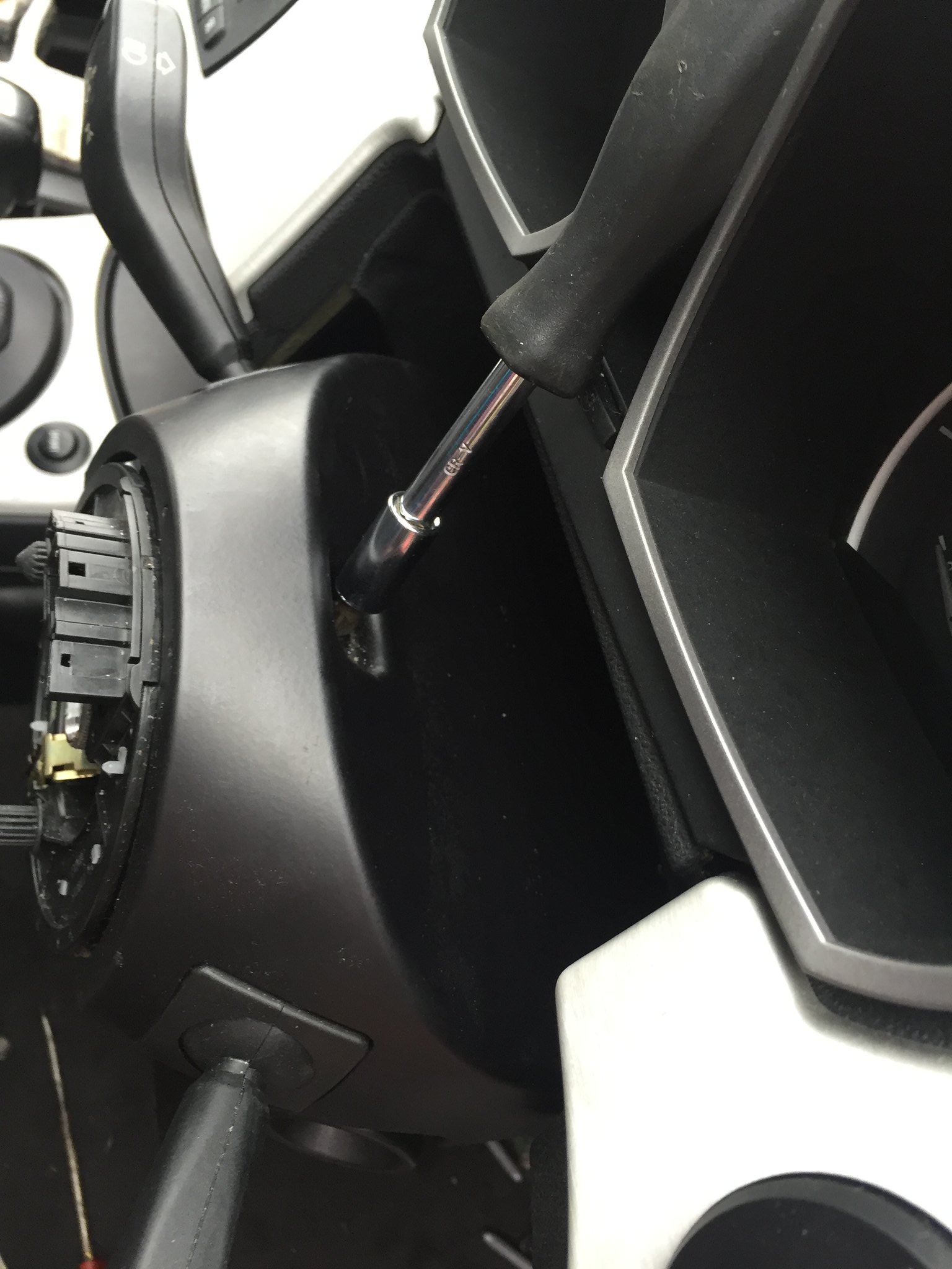

5) Unscrew the upper plastic shroud (adjust the column tilt downwards, then unscrew the '+' head screw at the top).

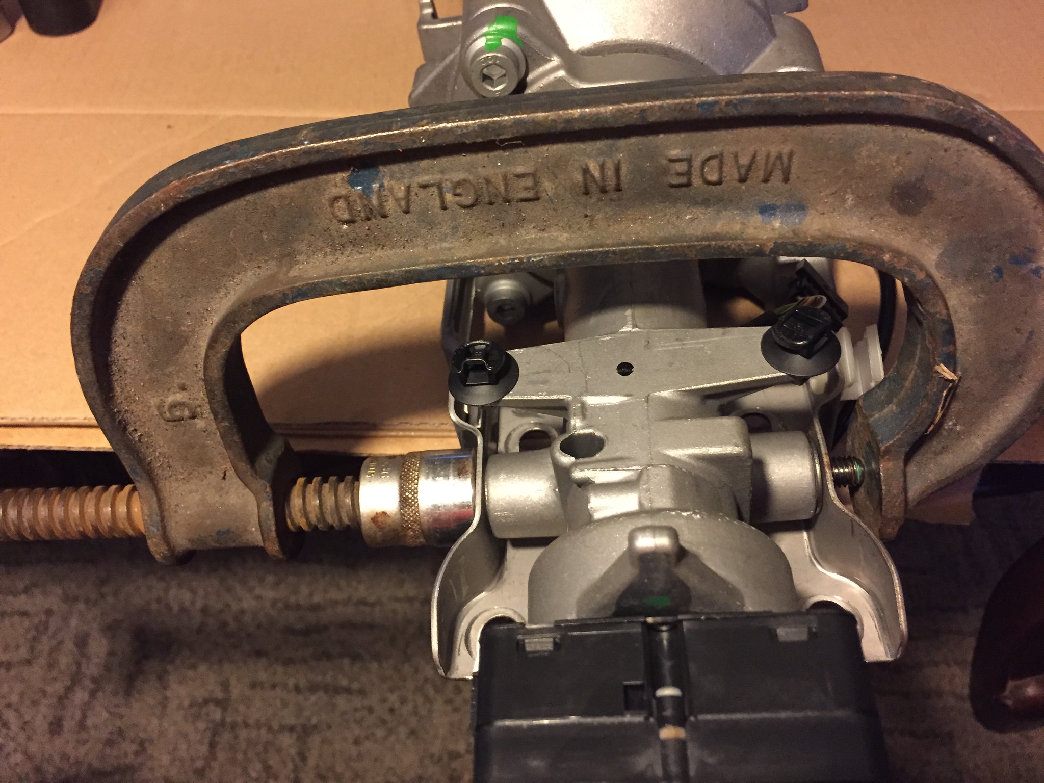

11). Lets start stripping down the column. Unbolt the hinge bolt at the lower end of the column. The bolt is in a snug plain bearing, so twist while pulling to extract it. I had to apply a little extra force with a g-clamp to get it started.

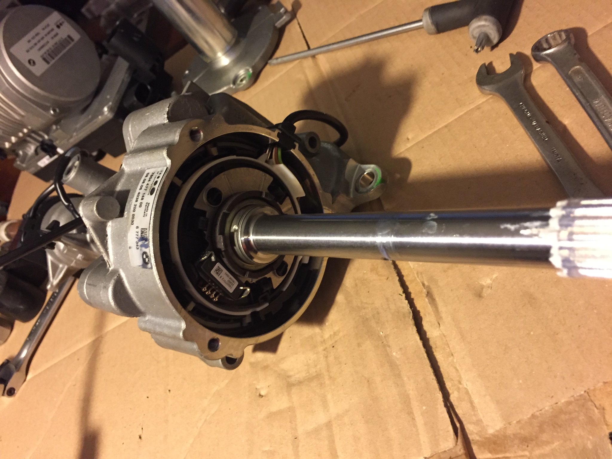

13) Unbolt the 3 torx screws that hold the upper column shroud to the centre section, and remove to reveal the torque sensor.
14) Although you can now see the torque sensor, access to it is still pretty limited because its set back within the main central casting. So lets keep going...

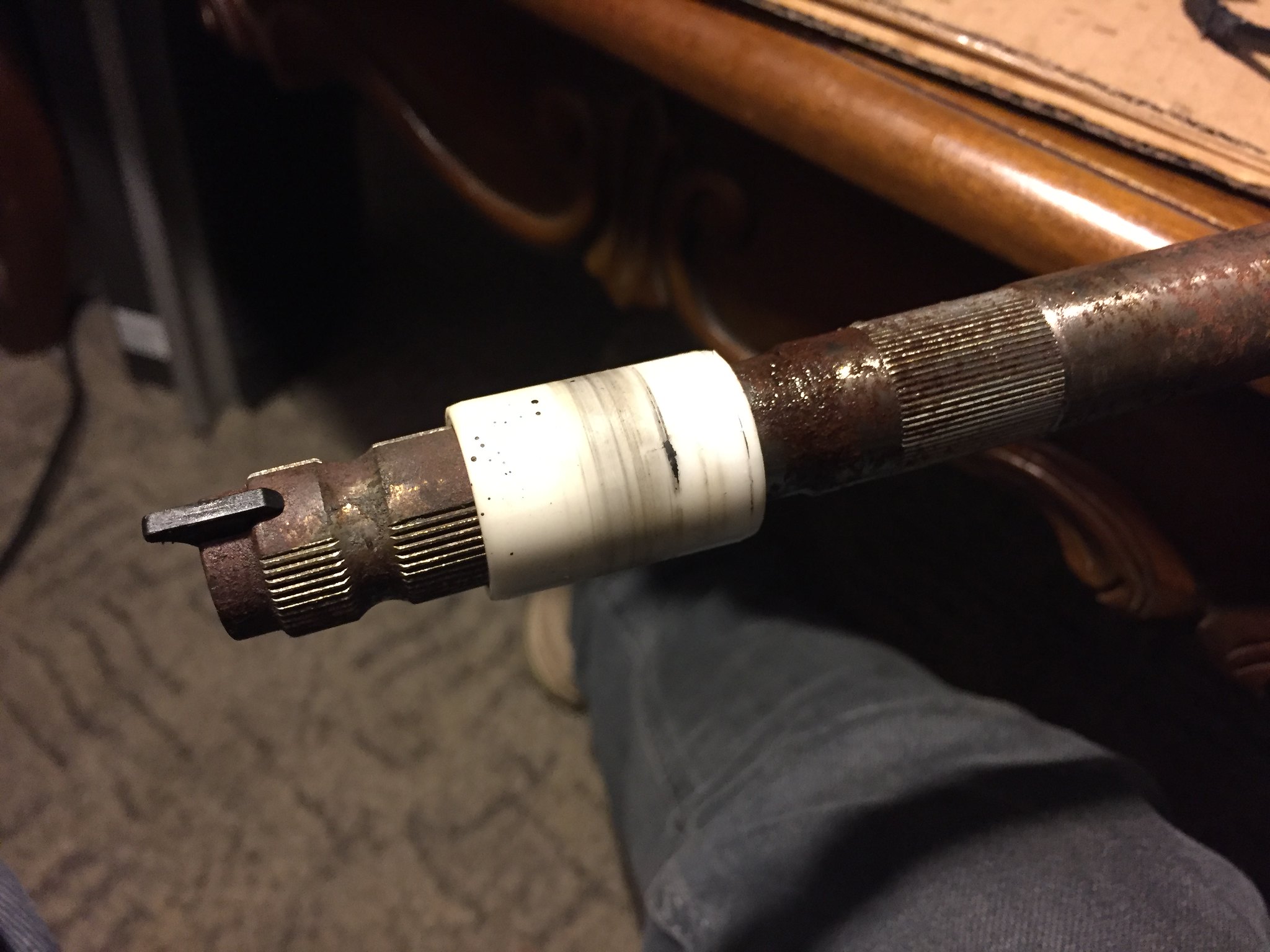

15) Unpin and remove the steering angle sensor. In order to slide it all the way off the column, you'll need to remove the black plastic keyway from the end of the column (apparently a replacement comes as part of the steering angle sensor kit), and slide off the white plastic slieves that sit in the bulkhead bearing.

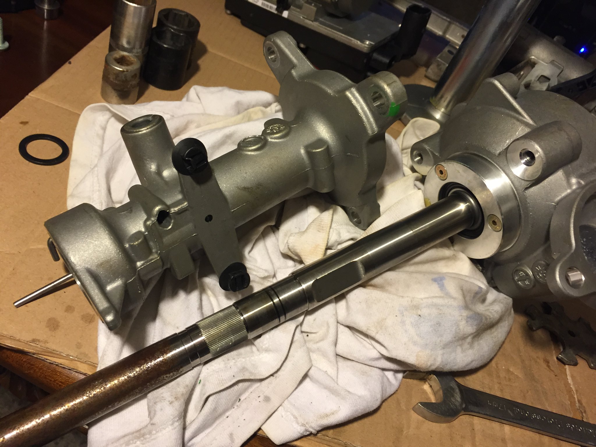

16) Unbolt the three allen-head bolts that secure the lower casting from the centre casting. This joint is spring-loaded, to undo the bolts evenly, and support the casing as it is released.
17) Unbolt the three small allen-head countersunk screws. These hold a plate at the reverse side of the roller bearing. I kept the bearing in place on the column ( i just removed the casing around it ), but if you need to change the bearing for some reason, you may want to keep these screws in place and press out the whole lot together).
18) Using a hydraulic press or similar (I used some spring compressors and a bearing splitter), press the central casting off its bearing and away from the column shaft.

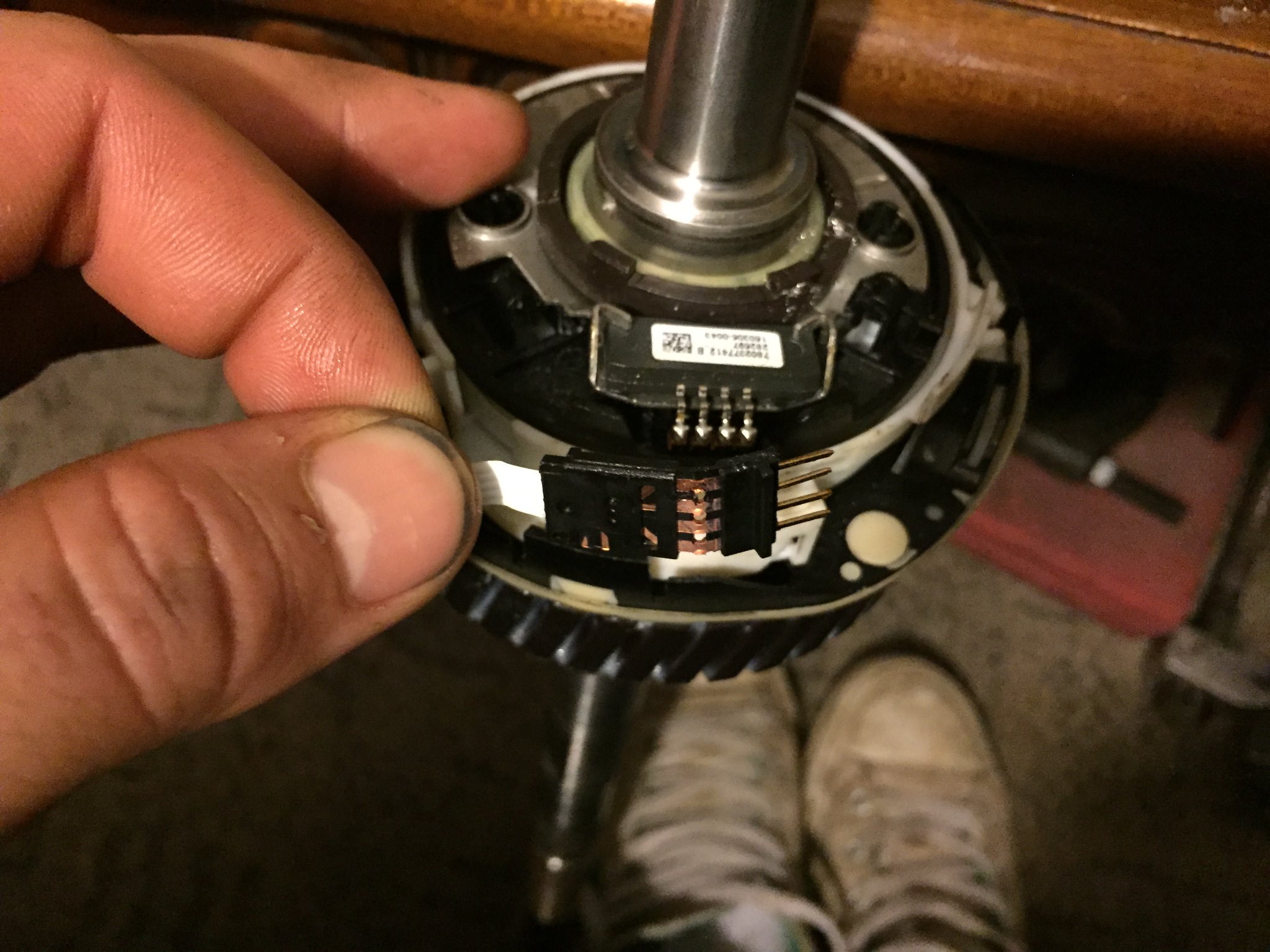

19) You're now left with (as far as I can tell) the steering column as far as it can be dissembled. The torque sensor is crimped to the column at two sections (the torsion bar bit is somewhere between and underneath). I couldn't see how the plastic gear was attached, but assume this was some sort of interferance fit.
To fix my problem, I had to repair the internal coil wires within the torque sensor. There's about a metre of ribbon cable that wraps in a coil around the steering column to allow for lock-to-lock movement. In fact, there's probably enough wire to allow for 9 full wheel revolutions before it will break. Mine had broken right at the outside end, so I was able to un coil the wire from inside to give myself the room to fix it.

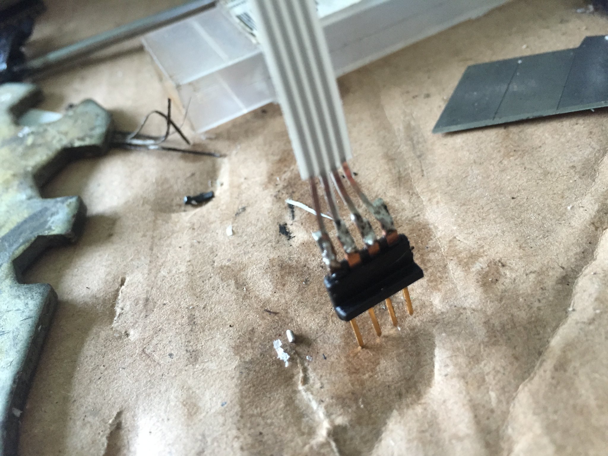

20) Cut the coil wire back to a nice clean bit, and strip it ready to solder back on to the terminal. (there's a surprisingly large amount of wire to work with, not just 3 turns worth) i had to cut the plastic terminal housing back quite a lot with a scalpel in order to give myself 4 neat contacts to solder.
21) Begin reassembly of the wiring back inside the torque sensor. I used some quick-setting two-part epoxy to secure the new connection in place, since none of the original plastic housing was being used in this fix.
