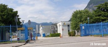

Collected info from dozens of replaced rear light clusters. That is, what a forum stands for.
A picture of Automotive Lighting (AL) in Tolmezzo (IT), I've passed by some weeks ago. Our rear light clusters were produced in Italy.
