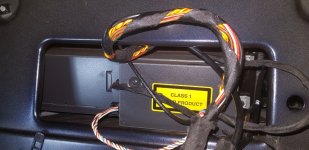

Not sure for the facelift but for me using the aux in was OK but I had no control over the music tracks. Plus I had to switch on the bluetooth unit every time & then recharge it. With this bluetooth adapter I can skip tracks etc. which makes it much more user friendly. Also it automatically starts playing from my phone when I start up the car. No recharging at all & really simple enough to fit too. The 2 plugs were accessed by lifting the rear bulkhead carpet in the boot. Plugged it in & secured it in the small cubby where the cd Changer used to be. Job done :thumbsup: .

All sorted thanks - managed to get to the plugs so now just waiting on the interface arriving so I can fit :thumbsup:
GMANLAW said:
I didn't have the CD changer but think all cars have the changer prep so I've found the plugs :thumbsup:
