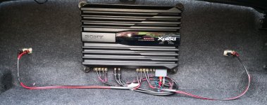

The Amplifier:
I fitted two 6mm x 60mm long studs onto the rear bulkhead to hold the amp in place and fitted two 6mm rivnuts to secure the top of the amp. I built some spacers out of ply for two reasons: To keep the amp away from the carpet and allow some air to flow behind; It was risky fitting the amp so close to the stereo (it is inches away) as there could easily have been interference. In this case my plan was to sandwich a grounded steel plate between the head unity and the amp. Thankfully this wasn’t required. The amp was powered with two 10 sq.mm power cables and a 60A fuse adjacent to the battery positive terminal (75mm of cable unfused). I made a pair of 2.5 sq.mm twisted pair speaker wires which connect the amp speaker front output to a 3 way crossover under the heater unit for my front speakers.
I connected the front speakers line in to the Head unit front line out and the rear speaker line in to the head unit sub woofer out.
