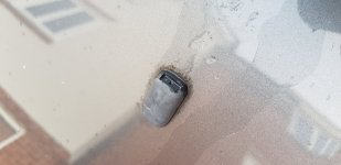

Anyone tell me how do I adjust these, water spray is too low. I've only ever seen little round things before that I adjusted with a pin. Mine are like this.

You may find they are slightly blocked, try blowing down them and see if it improves, if not get a new set.

Also check the reservoir tank is not full of crud

The only times I've had that problem it was due to crud in the reservoir blocking the filter on the pump so I'd start there.
The pumps are a push fit so they just pull out of the reservoir. I found an old toothbrush worked a treat to clean the filter.

Buy the originals from BMW and it will work.
PartNo 61667056731
https://www.realoem.com/bmw/de/part?id= ... 1667056731
About 40€ each.

you will need to take out the tank , the pump and filter unclip , then take apart and clean

As above, I had the exact same issue. I took the wiper fluid tank thing out, it's a few nuts. and there was loads of black shite clogged up at the bottom I just took the filter out and gave that a wash. Was a little black thing if I remember correctly. Works perfect now.
