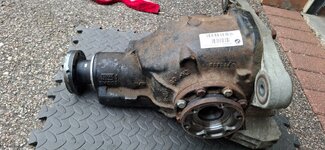

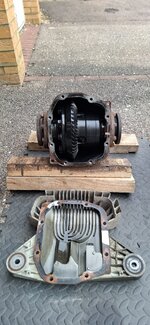

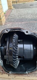

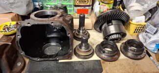

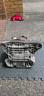

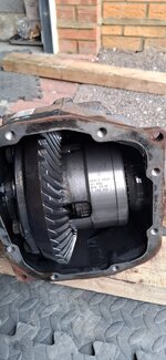

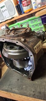

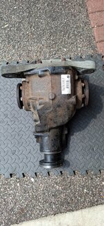

I just did mine. Still need to put the rebuilt unit back on but setting the diff to spec is very time consuming and requires access to hydro press and bearing pullers and drives. Still cheaper if you are confident to do a DIY, but if not, just pay a specialist.
Thanks Maupineda. The worse case scenario is that I remove and refit the diff myself but get a specialist to rebuild/refurb it.
This is what I did but a full refurb of all the bit around the subframe at the same time
