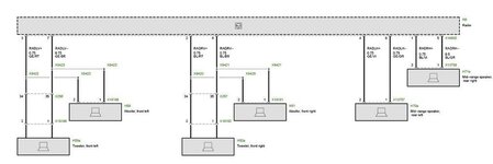

This is the output for the standard audio - no sub. Would you mind posting pics of your install, and maybe a description of how you did it, how you routed wires and trim etc. Im thinking about something similar so am very interested in what others have done.
