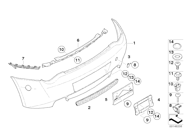

Found it:
part 7 and 6
51127158875
51127165177
When I push mine in it only lasts an hour. ^^^^^^^ The pic above shows for the M version. Better double check year and model application in case there are a few different part numbers.
