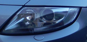

I'm going to feed my inner andysat ( :lol: ) and question the colour of my OEM Xenons. They seem distinctly yellow like standard H7s rather than the tasty blue of a Xenon light:
Washers would imply Xenon. Are BMW using dimmer bulbs with a diff colour temp so I don't blind everyone on the road like those 4x4s do?

I just had a look and long story short I fell to my knees and shouted 'noooooooooooo!' at the sky. Well actually I just opened the driver door, saw the height adjuster... played with it a bit to make sure it really was there and went 'hmphf'. Looks like basic H7s with a washer. Ah well!

I'm pretty certain you don't have xenons. Your headlights are the wrong shape inside.
xenon:
standard:
Notice the extra rings for the angel eyes?
*edit* too slow :)

Would agree they dont look like xenons... :(

They don't look quite right to me... This is mine
