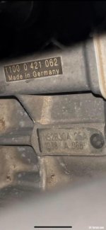

Just a quick question, seems as though my z4 coupe has had its motor replaced at some point. From the looks of things, looks like the engine came from overseas and there’s a code next to the engine number - 11000421062 which from googling seems like is linked to short blocks for z4s (happy it seems like whoever changed the motor did it properly and not just whacked in any old second hand motor).
Problem is I don’t have any paperwork detailing why the engine short block was changed or when exactly (although I suspect it had been done after 2018).
Engine number doesn’t match the original number on the paperwork although it is now linked to the vin # on all my registration paperwork.

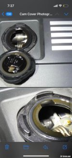

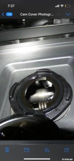

Should I take this as a positive in that I have what seems to be a newish motor? Looks fairly clean under the oil cap too..!

Have you seen the price of them!! Must have been done as part of a BMW warranty claim?

So does it seem like this is what’s been done looking at the numbers? Guessing this is a bonus for me? Car had 100k Km and is otherwise in really good condition/well cared for.
Also if it was done as part of warranty, I’m guessing maybe was done years ago and not more recently as I had thought and the engine numbers just never updated on the state databases?

That engine does look fairly new, no varnish under the oil cap, but any which way, with at least a 1000 km on it, work it to red line.
