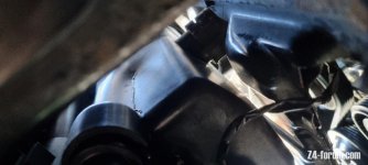

When I wiggle the hose that connects to the bottom of the expansion tank bracket the connection just above the drain plug I can see coolant leaking out.
So I've found my leak and it's the new expansion tank, it's gone in the same place as the original, only difference is it took 19 years and 100,000 miles for the original to fail but only 1 year and 1000 miles for the new one to go.
Twice now I've had a bad experience with febi bilstein, I guess there's a reason why the genuine bmw tank is a £100.
Jeez! Surely must be a warranty call on that one.
FWIW I fitted a Hella one on wifey's car 4 years back and that is still going strong...................... famous last words.
