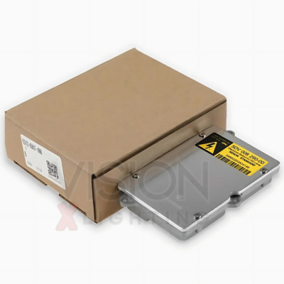

UPDATE: So I replaced the bulb no luck, so replaced the igniter no luck, replaced the module then nothing, so I thought id try my original igniter and it worked, whilst I was in the headlight I moved the wires around, so I'm unsure if its the wires or igniter.
Any suggestion as to what wire might be loose within the actual headlight I could review if anyone has experienced this? had taken a few heavy hits on pot holes so I reckon It could 100% be a lose wire.
Just hesitant to remove the light unit / bumper again after doing it for the module.

Chat gpt reckons to try the ballast, or could it be the bot at the back of the bulb?
Just hesitant to order the wrong bit 🤣
Mot Friday in typical fashion.
How quick can the ballast be replaced? Chat gpt once again said 15mins but I really doubt it.

I watched this to replace bulbs on my E88(125i convertible) and followed his advise to swap good bulbs/igniter over onto side not working.
I could only see it being the actual multi plug on the end of the car loom having a loose wire
