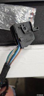

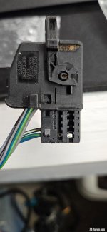

This is connector x887 and plugs into the drivers window switch. Unplug it from the window switch.
Lift the tab on the side and slide the connector out:

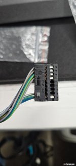

The green and blue wire in pin 7 is the 5 amp live from the fuse box. On the other side is the brown wire, pin no. 16:
Use the multimeter in continuity and connect the probes to pin 7 and 16 to see if there is a circuit. Don't worry about the fuse being blown, that's not a problem for now.
