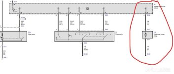

The wiring for the pump motor is as simple as it gets, 1 ground wire to the chassis and 1 power wire to the GM5. We know the ground and the power wires are good as the pump works (although un-commanded). The stalk was a good guess as it provides the drivers wishes to the GM5. So I have a feeling that your GM5 is bad. If it was a shorted wire it wouldn't wait 10 minutes before it started pumping the fluid.
