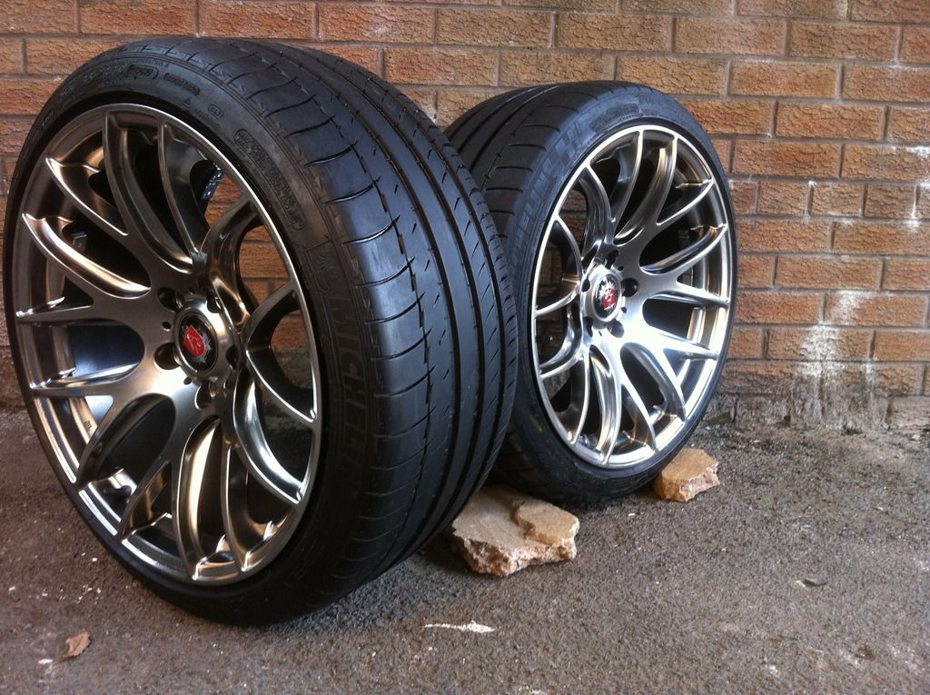

 Carlisle
Wondered if this size would fit my m roadster?
Diameter : 8.5x18 (Front) & 9.5x18 (Rear)
Bolt Pattern : 5x120
Offset : ET35 (Front) & ET40 (Rear)
If they do fit would I need spacers to sit right?
Cheers :thumbsup:
Cracker said:
Cheers Mr Wilks
My currant tyres fit them ok?
225/45/18
255/40/18
Borderline stretched on the widths , ideally 235/245 front 265/275 rear although i have 255 35 19 on my 9.5 rears & they're not what i would call " stretched "
