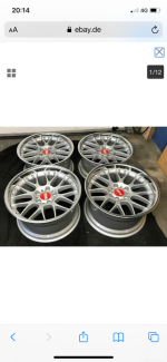

Decided to go with 8.5 on the rear as doesn’t seem to be any advantage trying to squeeze the 10” under
Will have
18x8.5 et38 front BBS RX507 225/40/18
18x8.5 ET22 rear BBS RX502 255/40/18
Just need to get them polished up and hopefully be looking like these
